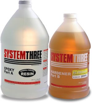

System 3 Epoxy
%20epoxy%20system_3_pourable
A. System Three, mirror coat
would be ideal for your application.
