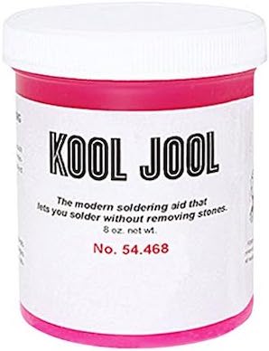

Kool Jool Compound
kool_jool
A. Sounds like you are burning or etching away the zinc in the alloy.
Check with a brass supplier regarding the proper solder and temperature to solder this material as it sounds like it is possibly getting too hot.
A protective coating over the brass around the joint may help, as may heat sinking the metal nearest the joint. Kool Jool
(a jeweler's compound for protecting stones and fittings near solder joints) is one possibility.
