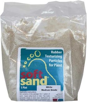

Soft Sand Paint Additive
Hi. Muriatic acid will etch concrete, but it's dangerous, destructive of plant life around the patio, and dangerous to get on you, in your eyes, or to breathe. Have you considered adding rubber "sand" to paint as an alternative?
