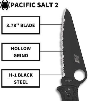

Spyderco H1 Rust-free
There are many wonderful theories here. Nice job.
From the point of view of a SCUBA dive boat captain and spearfisherman, I would like to give this practical advice. I have owned many knives (Buck, SOG, Camillus, West Marine, Myerchin, etc) and watched my crew and other divers with their knives and the only knife for me is a Spyderco H1.
Titanium dive knives will not rust, even if you NEVER wash them. However, they are not as strong as steel. I have bent my Ti dive knife in the bony head of a large amberjack. If you are not abusing your Ti knife like I do, you'll have no problems. There are plenty of Ti dive knives available and reasonably cheap. Stick with the big name brands (ScubaPro, Cressi, etc)
My favorite blade is any H1 knife from SpyderCo. They cost $55-$70. I found one in the ocean with barnacles on it and NO RUST! Amazing. They are scary sharp and strong. I've tried to make mine rust, but they just won't. They don't bend as easy, either. I did break the tip of one knife as I was using it as a pry bar. Seriously.
