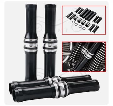

This is regarding my 2010 Harley Davidson FLHX Street Glide...
I recently purchased several "covers" and other equipment (i.e., floor boards, heel/toe gear shift linkage, lower rear brake pedal, etc), all billet black anodized aluminum.
After a few weeks in the sun some parts began to sun bleach causing a horrid sight to my beautiful bike. These parts are now a metallic brown color and getting lighter by the week.
The specific parts that are sun bleaching are hit or miss as not all parts came (not available) from the same source.
Before I replace the parts, I'd like to know what I can do ahead of time to mitigate this issue to ensure this does not happen again. Thankfully the issue is with the inherently less expensive parts like the rocker box covers, tappet covers, foot pegs and the like...
Is there some sort of sealant or other product I can apply prior to installation or re-apply periodically that would guarantee not to have this issue in the foreseeable future?
Every single part is a "two-tone" machined finish with the anodized black covering the majority of each part and has a bare aluminum trim edging as an accent (please see photo attached)
Mahalos in advance for any advice to keep it black!

A. Hi Brian. When you look at buildings with aluminum awnings, handrails, and roofs, you'll see that they are almost always within the color range from champagne to bronze. The main reason is that it is possible to deposit metal into an anodized coating which will generate this color and be completely resistant to UV fading, whereas other colors (including black) require organic dyes (similar to fabric dyes) which to varying degrees will suffer from UV bleaching.
We have appended your inquiry to one of several similar, long, and detailed threads. Some of it is highly technical and addressed to anodizing shops rather than end customers, but can be summarized as good black color stability requires thick anodizing, high quality UV-rated dyes, and proper sealing (here we refer to a process done in the shop to swell the anodize pores closed, not to any sort of clear coat).
I hate to be the bearer of bad news, but the parts which are badly fading are probably simply not of high enough quality for a motorcycle exposed to sun and heat.
Krylon seems to me to claim that their UV-resistant clear coat can protect stuff like this. I'm not so sure, but if you try it please let us know what happened.
