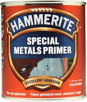

Hammerite Special Metals Primer
hammerite_spcl_mtls
A. Hello Graham, I live in England, trying a similar thing myself but in modeling. There are primers on the market, One is Special Primer for (brass and other metals from Hammerite) ⇨
and there is another etching primer you can use on brass, one thin coat leave for a week then top coat, I've heard it is good.
Best Wishes.
