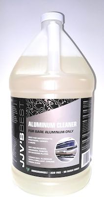

Aluminum Cleaner
A. I used JJVs and it is the best stuff; the only problem if you let it dry it leaves a film but all you do then I put some more on just for 1 min and it takes the film off. Great product it is a little pricey 48 dollars a gal but worth it
