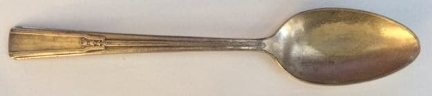

How to clean "Stainless Nickel Silver" flatware?
I inherited a set of spoon from my mum-in-law few years ago.
It says "SUPERFINE A1 STAINLESS NICKEL SILVER" on the back of the spoon.
They were not in good shape - kind of yellowish tarnished colour and various size of stains on them.
I washed them thoroughly with detergent but those stains are still there.
I asked several so called professionals - antique dealers, sales assistants at department stores etc...
But everyone gave me completely different answer.
Some of them said I can use "Silvo" ⇦ on eBay or Amazon [affil link] . Then another person said polish with "Brasso" ⇦ on eBay or Amazon [affil link] .
And the other one told me I need to re-plate spoons.
I went online but I couldn't find the answer.
So I have no idea what is the correct way to clean them and are they still safe to use?
Yu Blumenfeld
- London, UK
December 10, 2014
A1 Nickel Silver on eBay (affil link)]
A. Hello Yu. Most silverplated flatware is made of nickel silver. As the silver plating wears away, you see this discoloration because the plating and the base metal are not the same material. You can't remove such differences and they are not stains. I think maybe this flatware was silver plated at one time.
They probably have a metallic taste. The correct answer is probably that they should be sent out for silver plating; then they will not have a metallic taste and they will look good.
It is possible that when they were made years ago the intention was to use them without silver plating, but there have been a number of stupid flatware ideas over the years: I even have a piece of "made in Japan" copper-nickel-chrome plated steel flatware from perhaps the same time period and it was simply a bad idea. Maybe people therefore became more concerned with what the flatware was made of than plated with :-)
(Ted can offer longterm or instant help)

A. Hi Carla. There is nothing you can make food service items out of that nobody will say has "health risks"; but with tens or hundreds of millions of people using worn silverplate, I think it would be on the news every week if it was a significant problem.
what silverplate looks like when worn out
(this is what silverplate looks like when the plating has worn through)
Nickel Alert
nickel_detect
There are nickel test kits you could try ⇨
... but basically you can see the discoloration if the silver plating has worn through, and most people seem to get a "metallic taste" as well if the silver plating is worn out.
