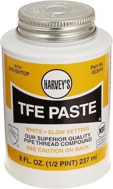

3. Another Teflon product I found is called Harvey's TFE Paste ⇨
It's Teflon powder in a carrier which slowly evaporates. It does not dry hard. It is sticky when fresh but is less so as it dries. I don't know how it would be in a high voltage application, but it should be water repellent. I plan to try it as an insulating coating where I cannot have even tiny surface currents. This material is also made for plumbing use.
