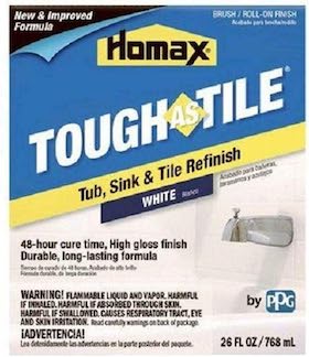

Q. I'm only planning on painting the outside frame and exterior portion of my shower/tub unit, so this area will not receive much direct water. Should I just go with Rustoleum Appliance paint or should I use something more serious? I'm hoping for minimal fumes and mess.
Auto paint sounds like a good option as well. Any suggestions or ideas? Thanks!
Terri Carrion
D-I-Y - Guerneville, California
A. Homax also has a paint made for tubs and showers called Toughtile ⇨
It does not come as a spray and only in white but it can be tinted with standard hardware store paint tints. Rust-oleum appliance paint, mentioned in the previous post, is not appropriate for a shower or tub. It is made specifically for metal.
