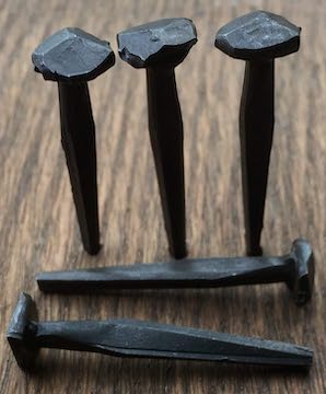

Rose Head Nails
Russ,
Did you find any products? I'm trying to do the same, but for rose head nails. Gun shops may have a product for guns.

Ken Schmieman, I need the same product on rose head nails as well as a green and black old appearance on outside metallic furniture. So please let me know if you find any. Anabella and Alec gave me good advice but I can't get their segments anymore...did anyone get their responses?
