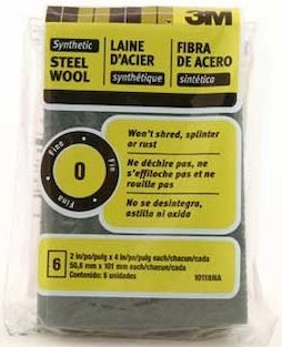

Synthetic Steel Wool
USE SYNTHETIC STEEL WOOL BY SCOTCH 3M .
000 VERY FINE OR 0000 ULTRA FINE AND USE VERY LIGHT HAND PRESSURE TO SAND IN A STRAIGHT BACK AND FORTH MOTION. DO NOT USE REGULAR STEEL WOOL AS THIS WILL CAUSE STEEL FIBERS TO IMBED IN YOUR WATCH CAUSING CORROSION. CHEERS, TIM
