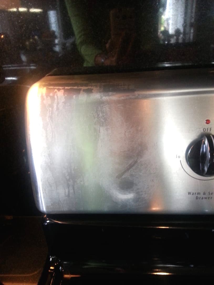

Q. The stainless steel on my stove "face" was ruined by steam from the tea kettle. I have found no images that are similar online. I very much hope I can get some help here. It probably doesn't matter, but the oven is made by Frigidaire.

A. For a home user, probably the best thing to remove some light heat discoloration from stainless would be one of those stainless scratch removal kits, like Scratch-B-Gone from that Barry fellow (BarrysRestoreItAll [a finishing.com supporting advertiser]), or similar kits you can find elsewhere online.

A. Hello, as the inventor and maker of Scratch-B-Gone, I feel particularly qualified to comment on your issue as we've seen it before. What you have here is heat and moisture damage to the Clear Coating manufacturers often put on this particular panel piece on the ranges. Often times the control panel will be coated while the stove deck may not.
Remedy: use a fine abrasive pad like that found in Scratch-B-Gone (gray pad) or a 3M burgundy Scotchbrite pad and some water. Keep in mind that any topical lettering, numbers and logos will be removed by this process if you work over these areas. Always work in grain direction, therefore Left-to-Right and back till coating is removed fully. Next, apply a clear lacquer from an aerosol can to protect. You can always reach out to us at Barrysrestoreitall.com for advice.
