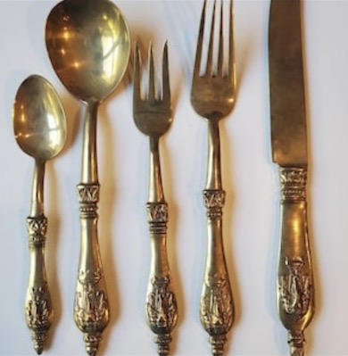

Q. I just purchased a vintage nickel bronze flatware set from Thailand. Will this be safe to eat off of? It's gorgeous but I'm now concerned if I bought this just for show. ⇦ Answer?

Q. I have a vintage Thai flatware set that looks like brass but could be bronze. The handles are decorated with the Ganesh elephant. I don't know the maker of this set, but I love them. I've been using them everyday for several years. I'm hoping there is no lead in them. I've attached a photo of them.
If anyone knows anything about this particular set (lead/no lead), I'd love to know. ⇦ Answer?

A. Bronze should be an alloy of tin and copper, which sounds safe, and Dirilyte/Dirigold has been used for many decades without any blatant warnings about possible toxicity.
But I don't know a practical way to be totally reassured that there is no mercury, lead, or cadmium in flatware if you don't know the details of its origin, so it's probably more a question of personal philosophy than known safety or known risk. Personally, I'd use it 🙂
A. Well, I wouldn't have any problem eating my dinner off bronze plates but I wouldn't use them as Frisbee's.

A. Bronze dishes ("Khamsa") were traditionally used in Nepal (for eating when I was there in the 70's and 80's. Perhaps also Thailand? They look like pie baking dishes, and were made by using sledge hammers to hot forge bronze by hand into molds -- I think of stone. We all sat on the floor to eat at that time (no tables) and eventually the lower rim of the plate would develop a hole from wear from being slid around on the clay floor. We'd send them back to the smith as scrap and get new ones. I ate off them for years without thinking of any danger. Copper and brass cooking pots, in contrast to bronze, must be tinned inside.* Bronze is safe to eat from without tinning. This is in general.....in any individual case there may be something wrong with the metal. Brass is more of a problem, especially if lead has been added to improve machinability (this is normal) and then the brass becomes scrap and gets reprocessed into flatware....
My impression is that the Thai bronze flatware is probably safe, but I am not absolutely sure. Maybe you should send a tiny bit to an analytical chemistry lab for testing. It might cost $20 US, I would think.

Ed. note: Our guess is that was bronze. Brass and bronze are pretty easy to confuse.
A. There are brass trays, some of which look like flatware. A lot are exported from India, and I've also seen them in Egypt...Probably they run from Morocco east to Bangladesh.
I have seen people put food on them to serve, but I think it is a dangerous idea to eat off them. Beside the traditional problems from pure Copper/Zinc alloys -- that is, Brass-- I worry particularly about the fact that since the industrial revolution lead has been and is very often added to brass to improve it's machinability. The lead does not actually dissolve into the alloy, but remains segregated in tiny globules I have read. The problem is that with use, particularly if a knife and fork are used and food is cut on the plate, you may end up ingesting this lead in small amounts. Particularly for infants and children, lead is very toxic and even an infinitesimal intake seems to have damage the intellect. Adults can tolerate more, but it is never a good idea to put this capacity to the test. If you eat with your hands, without cutlery, or with wood chopsticks there's probably less, but still significant, risk.
I used to be a crafts designer in India and the supply of brass to the tray makers there is from mixed scrap. The lead containing brass is melted down and enters the market mixed with non-leaded (this is rare) brass. So if you use the trays to eat off directly, you're asking for trouble. No one in India eats from them.
So the conclusion would be that the most likely explanation is that the flatware your mother refers to was bronze but she mistakenly thought it was brass. The two can look very similar, and most people would not recognize bronze when they see it. I have heard bronze can be hot forged (like iron) while brass normally cannot, so if the item is forged rather than cast it may be the former. The other possibility was that the flatware really was brass but was meant either to be decorative, or was a tray rather than a dish.
If it's brass, or conceivably could be, don't eat off it directly.

A. Unfortunately, no one can advise you what the composition of this flatware is based on a verbal description of what it looks like to you, let alone assure you whether it would meet your personal sense of safety. Mathew N's replies are very enlightening though!
You might find a jeweler or a scrap dealer who has a alloy sorter / scrap sorter X-Ray fluorescence testing machine ⇨
which could instantly analyze whether there is any lead in it, and whether it is brass or bronze. But, speaking for myself, if it is obviously expensive and a well made thing of beauty, I'd use it.

There are dozens of brands of metal polishes of several general types. Brasso is one type, and it creates a beautiful warm glow but is quite slow on heavy tarnish. Other types, perhaps because they contain sulfamic acid, work much faster and easier, although the result may not be quite as warm. I would try something like Barkeepers Friend ⇦ on eBay or Amazon [affil link] , which you could follow with the Brasso.
If that doesn't do it, then the problem is probably not tarnish but the fact that the surface is no longer mirror smooth and needs to be power buffed. You can send it to a plating shop for that or you can try to do it yourself with a buffing wheel and buffing compounds, or on the cheap with a buffing pad in a power drill and Mothers Mag & Aluminum Polish ⇦ on eBay or Amazon [affil link] . Good luck with it!
Q. I just purchased 2 large sets of vintage Thai flatware, from two separate sellers on eBay . I am fairly certain they are Thai in origin and were described as being from the 50's to the 70's. After reading this thread, I am concerned they might be brass or have lead in them.
The metal is a brassy gold color, feels a bit heavier than stainless pieces, but the smaller pieces (desert forks) are easy to bend and I snapped one in two easily. The interior was also gold in color. Also none of the knives are particularly sharp. They go through the dishwasher easily and when left in water have not tarnished so far.
They look well done otherwise with a three headed elephant on each item's handle and a finial on top. The larger serving pieces feel quite heavy as well. Each set is about 144 pieces and comes in a wooden lined box and appear to be identical to each other.
Do these sets sound familiar to anyone and can anyone vouch for their safety or lack of it? Or does anyone know of Thai fabrication methods that ever utilized lead in their flatware?

A. Hi all,
I am a European (mostly) trained dermatologist (Diplomate of Dermatology, University of Londona; Fellow of the Deutscher Akademischer Austauschienst or the German Academic Exchange Service, University of Hamburg 6 years, Fellow of the American Academy of Dermatology, etc) and author of two textbooks of Dermatology.
Just wish to inform the visitors of your site that as my subspeciality is Allergology, I can tell you not to use flatware with Nickel.
One may even for years seem "ok", using flatware with nickel but the allergy will just one day pop up.
Bad scene.
Best
- Makati, Philippines
A. Thanks, Dr. Huang. Even as a layman I agree that nickel allergy is an acquired problem and a terrible curse.
What are the implications of what you are saying, though? Certainly when the silver plating on flatware wears away and reveals the nickel silver that lies under it, it has a metallic taste, and I can believe that it is leaching nickel to some extent.
But I taste nothing from 18-8 and 18-10 stainless steel (type 304 and 316 stainless steel), and metallurgists tell us that they do not leach nickel and are safe. Do you disagree with that assessment and feel that only 4xx stainless steel (18-0) is safe? Thanks again!

I recently inherited a 132 piece brass with wood (teak?) handle cutlery set from my elderly in-laws. It was personally purchased in Thailand and carried over. I am sure it is mid-century. The cutlery handles have a "roman numeral 1" type pattern that go all the way around as opposed to just the front.
My question is, why are none of the pieces stamped with anything? The only stamp is on the wooden box buckles. It reads "LION".
A Hauck- montreal, Canada
August 22, 2021
A. Hi. I think you are correct about no markings. The "roman numeral 1" is probably simply the clinching of the brass cap to the wood handle -- you'll see the same on pencil erasers; and the "LION" may be a brand name on the hasps rather than the flatware.
