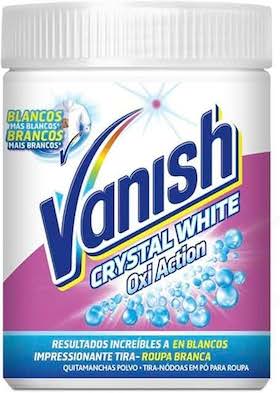

Vanish White
vanish_white
A. I have found Vanish white
works with my white gold rings, I discovered it while hand washing my clothes.
Caryn Veenstra
- Newcastle, U.K.
