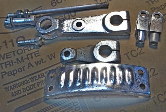

Q. Removing remaining chrome from cast and stamped steel motorcycle parts?
Good info found, muriatic acid it is, guess I need to get some milk of magnesia, and we can now add 2022 to the thread timeline!
Parts were wirewheeled to remove loose chrome and rust then immersed in evaporust for several days. More chrome loosened in the evaporust bath.
No chemical removal of chrome has been attempted.
Top arm was wirewheeled again.
Other parts are as removed from the Evaporust, rinsed with tap water, with dull Nickel? and shiny remaining chrome.
The goal is "chrome plater ready" parts would like to do some additional smoothing polishing so finished parts are a bit better than 70's Japanese production parts.
