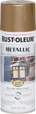

Rust-Oleum Antique Brass
However, it is less expensive for the manufacturer (and safer for him, because brass plating is cyanide based) to make such parts by nickel plating them and then applying a translucent brass-toned electrophoretic lacquer than to actually brass plate them. Consequently there is a good chance that inexpensive "brass" rods don't have any real brass on them so antiquing solutions won't work.
Since these are not expensive heirlooms, and since they already have some sort of organic (lacquer, clearcoat) finish, I'd probably try a spray can of Rustoleum or Krylon "antique brass" paint ⇨
But you could buy one set and try removing the lacquer before committing to how to handle 22 sets. Good luck!
