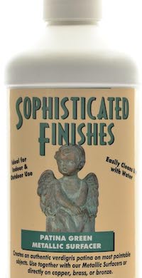

Sophisticated Finishes Patina
A. Hello Barry, Rosie. We appended your question to one of several threads on this general topic, If you don't see enough info here, search the site for green patina and you will see many suggestions, formulas, and comments.
Too answer the need for "instant" patina, a commercial product for that purpose is .

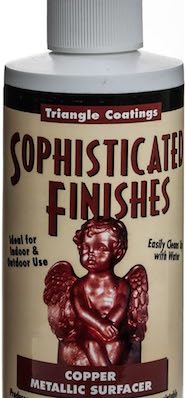

Metallic Surfacer: Copper
Hi Virlouvet. If you really just want paint, I'm confident that Rustoleum and Krylon and the other companies who offer paint for outdoor metal will have a color faitly close to verdigris.
But another approach is to "paint" on some copper metal surfacer, which will leave the surface full of tiny grains of copper.
and then apply the instant patina discussed immediately above to turn the copper to verdigris. Good luck.
