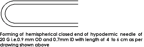

Q. Dear Sir,
We are interested in forming hemispherical closed end of hypodermic needle of 20 G i.e.0.9 mm OD and 0.7mm ID.
Material Type: Stainless Steel 304, 316 or 316L
Condition : Hard and preferably should be maintained
We are attaching drawings for your reference and suggestions to us.

A. Amrut,
My first suggestion would be for you to go to a local ‘pipe bending Company’ for some advice … although you can be l00% sure they would have never ‘bent’ something so small !
Bend radius! If you cold bend your needle, either it will break or it will flatten out. The absolute min. bend radius I would consider is 6 x diameter and that’s using heat to form over(i.e., around) a mandrel. Maybe start off @ 8. The larger the radius, the better
(quality) the bend.
You state that the needle’s end(s)are closed. In the metal pipe bending field in order to make perfect bends, they use a ‘rosin’ which is heated up to well under 100 °C but, upon cooling, becomes solid. This allows for excellent bends to be made in certain materials (copper) without heat.
Somehow that sure doesn’t seem feasible for you. Summary… use heat (to red hot), use a large bend radius…. and cross your fingers!

A. I understand your drawing to show a section of the tube, with the end closed. I see nothing in your query or sketch about bending. I think Freeman has mis-read the situation.
Assuming you need a gas/liquid-tight closure, you’ll probably be able to get it done by a company that manufactures thermocouples. The usual way of closing the end of the metal sheath of mineral-insulated thermocouples is by TIG welding. This is on tubing down to a couple of mm inside diameter. It’s a small TIG-welding setup! For a tube as small diameter as yours, you wouldn’t need any filler metal.
Probably, electron-beam welding would also do the job OK, but might be a problem accommodating the tube in the vacuum chamber. I’d go for the TIG.

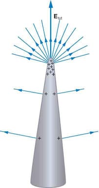

Q. We perform electropolishing on small bent suture needles used in surgeries and operations. Our bath is around 40% H3PO4 and 40% H2SO4.
We have problem concerning the quality of the tip of the needles that it becomes too fragile after EP.
Our process team from our mother company insists that the diameter loss be between 6 to 12 microns, to prove that the needles have gone through EP.
Conforming to these instructions, the tips are still as fragile at the low extreme (6 microns of diameter loss) as it is at normal setting (around 9 to 10 microns of diameter loss). By fragile, I mean that the tip easily become crooked during manipulation of the needles after EP. It seemed as if more material is dissolved around the tip rather than the tip itself (difficult to verify this as we are dealing with really small parts).
Therefore, I was wondering how does EP attack sharply curved points. I read somewhere that electrical charges tend to accumulate on sharply curved areas. How does this affect the EP? Does it dissolve the extreme tip at the same rate as the other parts of the surface?
Do you think by changing positioning of the needle we can have different effects? I.e. having the needle pointing towards the cathode.
Or do you think it correlates with the type of bath that we use?
Thank you in advance for your support.

It all has to do with how electric current flows off the microscopic features of the piece while immersed in an electrolyte bath. You are correct in that the current flows more off the “peaks”, but the tricky part is learning how that works when you have a macroscopic feature like the needle tip. As you said, the tip gets thinner rather than being solely dissolved down from the point.
I’m not well versed in this, other than to know it’s very complicated. In many respects, electropolishing is as much an art as a science, being able to craft the electrode arrangement and such in order to control current density as required for the shape of the piece.

Thank you for your input. It is interesting that you talk about electrode arrangement. I just noticed an error in my previous question. Actually, the tip of the needle is parallel to the electrodes.
Q. In theory, if I put multiple cathodes around the workpiece it could work no? Or an electrode with a concave shape that covers until the front of the tip.
We will try to do some tests of having the needles pointing towards the cathode to see the effect.
Besides that, do you know about the accumulation of charges in corners or at pointy areas? (see photo)
I am having trouble understanding how this will affect EP.. Logically I thought it would help dissolution at the tip but it is not the case.
