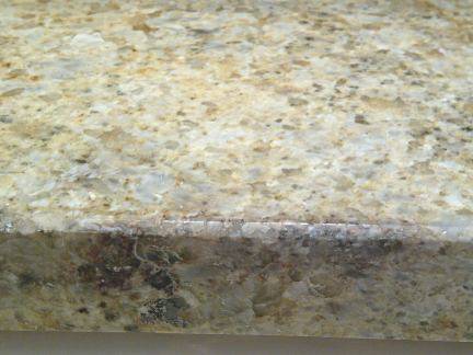

Q. Dear Readers,
I recently stained my granite counter tops, (the front as well as the bull nosed side)
I have tried hot dish washing liquid but nothing stronger for fear of ruining the finish.
I was transporting hot grease from a metal container to a plastic container. When I tried to lift it the bottom and side melted on the spot and grease spilled everywhere. I did clean it up immediately but the next day two stains appeared. Fearful of using a hard abrasive cleaner I opted to seek advice on the correct approach to take.
If you could help me with this dilemma it would greatly be appreciated.

Q. Does anyone know how to get out stain from a granite countertop caused by someone spraying WD-40 ⇦ on eBay or Amazon [affil link] up under the countertop to lubricate the kitchen sink faucet. This inadvertently soaked the granite from underneath and a dark stain spread to the top and lip of the countertop overhanging the sink. Any help will be greatly appreciated. This is a brand new, light color granite countertop.
Steve L [last name deleted for privacy by Editor]
homeowner - Newtown, Pennsylvania
A. I put in new Paradiso granite tops, and within 24 hours had an olive oil stain. The tops had not been sealed as I proved that sealant prevents this. Using a crème brulé torch [affil link to info/product at Amazon] I gently played the flame over the stain and Voilá - stain gone in seconds.
