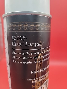

A. Hello Michael,
I think what you might be looking for is a ferric nitrate patina. Indeed, it wouldn't be very durable, but after you knock off the loose scale and seal the patina with a clear coat, you shouldn't have too many problems with your customers. Besides, they're the ones who that are buying rusty furniture, I'd guess it would be their own fault if they get rust on their pant bottoms! Good luck finding a rust colored paint, look in finishing.com's literature section for the patina books

Nikolas 2105 Lacquer
nikolas_lacquer
! I hate rust! It never sleeps. Why anyone would want rusty furniture is beyond my understanding. However, I like the reply from G.J. Nikolas [a finishing.com supporting advertiser] (my favorite lacquer company): "Seal it up". Years ago I used to sell antiques. A finish I used for iron which was well received was to apply black shoe polish with a tooth brush and then buff it. After this I would "seal it up" with a coat or two or lacquer. G.J. Nikolas 2105 Clear Nitrocellulose Lacquer
Damn good stuff. It can even be applied when it is raining without fear of whiteout.
If you are stuck on the rust look, gut feel tells me to make a vapor cabinet where your articles are exposed to the vapors of HCl rather than brushing it on, they will form the seeds of rust in a day time provided your metal is clean. Sandblasting is an excellent prep.

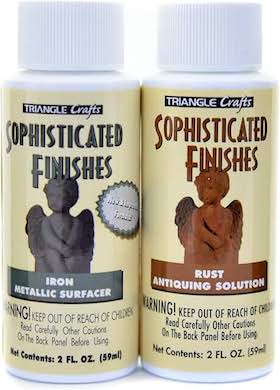

Q. Thank you for the rust referral. I'm thinking about trying to "rust" up a black metal chandelier. My question is if I want it to be a worn out white look, should I paint it white first and then use the modern options antiquing solution?

Metallic Surfacer
(2-step Rust Finish)
instant_rust_mo

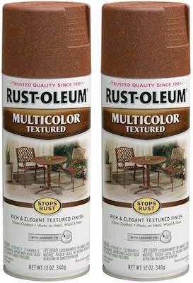

Rust-Oleum Rustic Umber
rust_ic_umber
A. Hi,
You can also use Rust-Oleum Stops Rust Multi-Color Textured Rustic Umber Spray Paint. It gives rust like finish. This paint can be applied on wood, metal, concrete, masonry and more.
