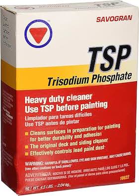

Hi, Randy. Unfortunately your question is just a bit vague, because we don't know the age of the roof or why you are painting it. If it's quite old and rusty, any primer for metal, followed by any outdoor paint designed for metal is probably okay, although a rust converter ⇦ on eBay or Amazon [affil link] first might be a good idea.
If it's a newer roof, the galvanizing can definitely cause you adhesion problems. Scrub with trisodium phosphate ⇦ on eBay or Amazon [affil link] , then use a self-etching primer for galvanized surfaces. Good luck.
