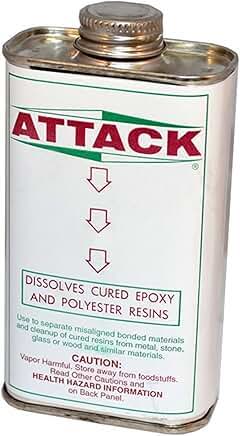

A. Dimethylformamide will remove epoxy (or any type of synthetic plastic for that matter) but is a very toxic chemical which requires special safety precautions. Don't even think about using this chemical until you have read the MSDS and clearly understand the hazards and precautions associated with this organic solvent.
A less potent version is available from many lapidary suppliers, sold under the name of "ATTACK" which is a dilute solution of DMF and acetone. Again, be careful as DMF is a known carcinogen and WILL fry your liver and kidneys--Hope this was helpful--Les M. Barnes, L.A.C.

A. I believe a product that will work for is called ATTACK and can be purchased at most jeweler supply houses
Good Luck
