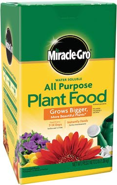

A. May sound crazy, but I used Miracle-Gro diluted w/ water on my copper bays and it worked. It's much safer, easier and better for the environment than muriatic acid.

A. Miracle-Gro for African Violets in a liquid form is GREAT!.
I brushed (like I was painting) on the copper and it turned a lovely green the sunny day after I finished the job!

!. Miracle-Gro African Violet Liquid Food.
diluted is the safe way to go... It was actually used in the Statue of Liberty restoration work. It was used to get the replaced copper to match the existing green copper.

Q. THE MIRACLE-GRO SOUNDS LIKE THE BEST OPTION. IF IT WORKED FOR THE STATUE OF LIBERTY, IT SHOULD BE GOOD ENOUGH FOR MY NEW COPPER ROOF.
BUT WHAT PART MIRACLE-GRO TO WHAT PART WATER?

Q. Several folks have suggested Miracle Gro for African Violets.
You may not be aware that Miracle Gro no longer makes that product. Others did not specify that specific type of Miracle Gro. Thus my question is what type of Miracle Gro product works well besides the now unavailable African Violet?
One additional question:
After applying Miracle Gro a few times, why does the patina vanish once the rain wets the surface. After the rain dries the patina returns.
Is there something that can be done to maintain the patina color even when the roof has gotten wet?

Q. I am trying to use miracle grow to turn some small decorative copper brackets green, but I can't get it to adhere--It just beads up on the copper and I end up with little spots of color. I've tried cleaning the copper with vinegar and strong soap without success. Any ideas?

A. About using MiracleGro for green copper patina, yes, it works!
Paint it on thick -- make it a paint-like substance with a little water ... needs nice bright sunshine to dry -- a nice patina of green always looks different while it is raining, but it will come back to green patina when sun comes out. Give it a try.
