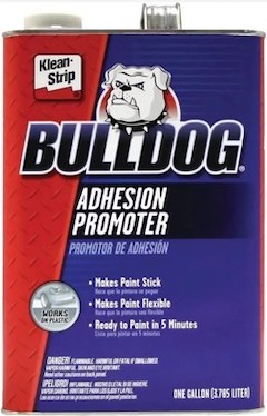

Bulldog Adhesion Promoter

thumbs up sign I'm not sure there is a Bondite, Louis :-)
We've looked for years for a primary reference to it, but all we find is messages in forums where people think at some point somewhere they might have heard of the product from somebody for some reason, maybe, or something like that :-)
It may just be a misspelling so people are referring to different products and we'll never find it. For example there is a "BondIt" and a "Bond It" and a "BondTite".
However, you might consider Bulldog adhesion promoter on eBay or Amazon [affil link] or Krylon Fusion on eBay or Amazon [affil link] , which is a paint designed specifically to be used on plastic. Of course, all plastics are not created equal and Freeman may be right that neither these nor the mythical Bondite will adhere to polyethylene. Good luck.

A. We've tried several methods of painting UHMW PE with no luck. The Fusion Krylon paints are good on other materials, but definitely not UHWM. It simply slides off.
If $300-500/gal primer does not discourage you, then talk with your plastics supplier. There are options out there.
