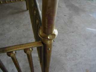

Q. I am thinking of purchasing an antique brass crib. This crib appears to be very tarnished. Brasso polish does not appear to easily remove the discoloration.
Is there a dip that can be used? Also since this is quite tarnished..is it possible that the shine would not return?
Merrill Gottlieb
- West Palm Beach, Florida
A. Hi Merrill. Thanks for sending us the picture -- which prompts this question: have you tried a magnet on the bed? It sure looks to me like a brass plated steel bed with much of the brass plating worn off. What's gone is gone, and if's it's a steel bed with the brass plating gone, the only resolution is replating.
