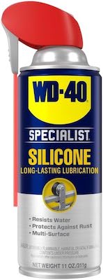

Silicone Spray Lubricant
A. A mist of silicone spray ⇦ on eBay or Amazon [affil link] .
Wait a minute, and removal is smooth and easy. I roll the paper backing off using a broomstick or 1x1.
David Halloran
- Somerville, Massachusetts

WD-40 in bulk
wd_40
A. The best thing is to use is WD-40 ⇦ on eBay or Amazon [affil link] ; you let it soak overnight or 2 nights and then you take a piece of plastic on the plastic and scrape it off because plastic will not scratch plastic. It will slowly start to come off and then take paper towels and keep wiping the glue till you get it all off and then use more WD-40. The best and the fastest thing to soak all the paper with WD-40 you're probably going to need a little bit of it so I would go to the store and buy a a bottle of it not a spray bottle better to just buy it by the gallon you're not going to use that much but it has a lot of uses. Hope this helps; it helped me on a lot of acrylic that was old and there's no way you could have got it off without this s***, trust me. Hope that helps ... have a great night
