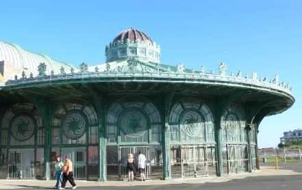

thumbs up signHi Bruno. Many foolish towns & counties have restrictions on shiny roofs, and won't let you do copper unless you ruin it by artificial aging as you describe .
The real thing: 1. Erie-Lackawanna train station, Hoboken, NJ. 2. "Carousel building", Asbury Park, NJ.
hoboken lackawanna station asbury park carousel_bldg
A natural patina is a beautiful thing, but it takes a lifetime. Using natural copper building materials is like planting a tree. It's not for your own pleasure, it's a gift to future generations. Nanny-state regulators aren't sticking it to their neighbors but to their own grandchildren -- denying them the architectural legacy which they themselves enjoyed :-(
