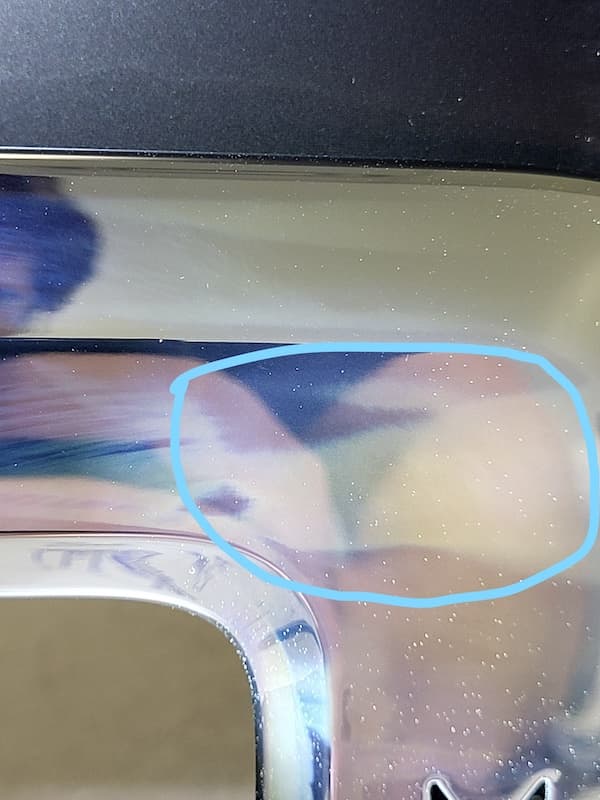

Q. We are running into a similar issue at my decorative chrome shop. The defect appears to be a rainbow iridescence that is VERY distinct only on certain parts (we see it on everything to varying degrees). We have isolated the issue to our Ni anodes but can turn the defect on-and-off with good ol’ STEP enhancer. Does anyone have any other ideas as to what could be occurring here?

! We identified the problem originating between MPN and electrolytic chrome pre-dip. Here are things we have attempted:
pH low in MPS
pH high in MPS
Carbon treat MPS
Permanganate treat MPS
Low current MPS
No current MPS
High current MPS
No current chrome pre-dip
High current chrome pre-dip
Decant chrome pre-dip
Add STEP enhancer to MPS
The addition of the STEP enhancer to the MPS (causing the nickel to become more noble and risking white wash) has been a quick fix as of late to eliminate this iridescence. The sustainable long term fix was to change out anodes in the MPS. Has anyone else been able to address this issue another way?
