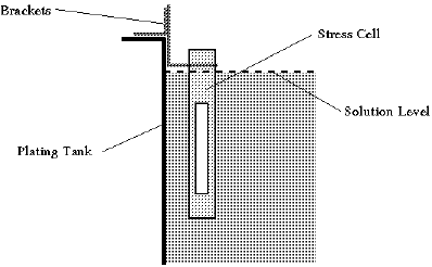

The nature of electroforming itself dictates that of most practical interest to the process engineer should be low stress levels which, as noted earlier, cause the least distortion in the electroform. With this in mind, the simplest yet sensitive enough measurement technique for industrial applications is still the bent strip method. One of it's present commercial versions(7) utilizes disposable brass two-legged strips whose opposite sides are plated and the resulting leg deflection caused by deposit stress is measured on a simple scale
(Fig. 2).
Fig. 2
A formula is used to convert units of spread into the deposit stress level. Tests can be performed directly in the plating tank by using a slotted tubular cell (Fig. 3) which has the added advantage of precluding any possible errors during electrolyte transfer to a laboratory cell through dilution, contamination, temperature variations, etc.
Fig. 3

This seemingly endless list of factors may make any attempt at stress control look futile at best. And yet, a methodical approach coupled with tight process control and good housekeeping makes stress control during electroforming perfectly possible. An important note to make here is that a particular plating tank represents such a unique combination of variables listed above, that it is preferable to measure stress directly in the tank rather than hope to recreate the same conditions in a laboratory cell.
A somewhat closer look at the list of variables above will reveal that at least some of them are either constant for a particular plating process/tank combination, or can be kept constant with relative ease (concentrations of main components, temperature, pH, cell geometry, anode/cathode ratio, agitation). Once a particular plating chemistry has been selected and initial process variables fixed, one needs to map an important process baseline - the bath stress profile. Stress profile is the relationship between deposition current density and the corresponding deposit internal stress. This can be easily established by repeating a stress test several times at varied current densities keeping the rest of the variables constant. Sample stress profiles for several sulfamate nickel electrolytes are shown in Fig. 4.
