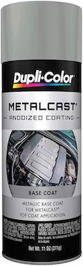

Duplicolor Anodize Red
Duplicolor Anodize Blue
Duplicolor Anodize Ground
The look your husband will want to match the movie shield involves NOT priming the metal. The movie shield (as shown in your samples) has the bare metal in the center sta and second ring. The red and blue need to show the metal through the paint. The original prop is anodized aluminum. So you want to mimic that. There are several people in Prop making message boards completing a similar project as you. Go to www.rpf.com and search for captain america shield. The best paint match will be Duplicolor red and blue Anodizing paint in a spray can ⇨
Should be able to find it at Auto parts stores. Again, no primer.
