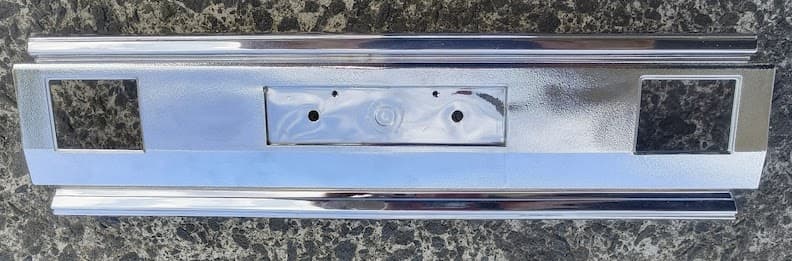

Q. Hi everyone,
I am new to this site and am very much a layman restoring a classic car.
About 2 years ago I had this ABS car trim rechromed in order to restore it to the factory finish.

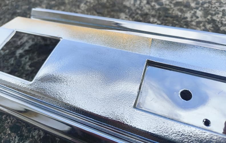

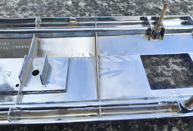

It has sat for a while before being painted and my panel shop has informed me that a decent amount of the chrome has started lifting.
53699-2a 53699-2b 53699-2c
Unfortunately, the shop who did the finishing has shut down and there are no alternatives that I can take it to (I sent it from NZ to Aus to have this work done).
I guess the good news is that the part which is lifting will be entirely painted.
But that leaves me with the question, what do I do about it? The surround needs to stay chromed and seems to be well affixed to the ABS.
Can I somehow very gently cut away the area that is lifting and just paint the ABS? Can I try and spray some adhesive underneath and squish it back down? This kind of work is very foreign to me.

A. Hi Leon,
Sorry this happened to you and keep your fingers crossed that the chrome will stay adhered where you need it to.
I would not suggest trying to lift anything to tuck epoxy under it as that will further stress and lift things. I would suggest cutting away whatever is loose and applying an epoxy bead at the boundary of the cut edges, i.e., across the top of the plating and the bare plastic. Epoxy is strong and I think this will hold it without prying under it and making it worse.
