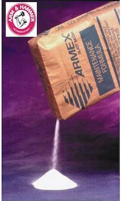

Why does Baking Soda Blasting prevent rust?
I was searching on the net for different types of sandblasting, and found soda blasting.
They use baking soda to blast off paint and grime on a variety of materials without digging the blast media in the materials surface. it has some other advantages over sand or the conventional blast media
One advantage that I especially like is the fact if you soda blast on a a metal piece until its bare to the surface, it won't rust unless you wash off all the baking soda residue.
I know it's already used professionally for blasting off the paint on cars.
How is it that the metal not rusts, even if it lays there untreated for a couple of weeks.
Anyone knows why or has experience with soda blasting.

Hi, Elky. Baking soda (bicarbonate of soda, sodium bicarbonate, NaHCO3) is slightly alkaline and is dry, two environmental factors that tend to deter rusting. Also, compared to one of the alternatives, acid dipping, which leaves metal active and prone to flash rusting, you are avoiding that. I don't think it's a guarantee that metal won't rust for a couple of weeks, but it certainly slows rust.

1. Am I able to use my existing sandblasting equipment?
2. Where do I get the Baking soda in the right consistency and amount from?

Soda Blasting Media
Hi, Karl. Conversion kits are available for your blaster. The soda is available labeled as soda blasting media. Good luck.
