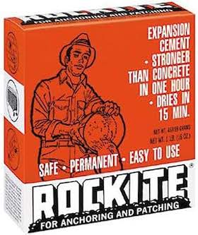

Rocktite
A. We also have a set we inherited but I repaired them fully 10 years ago using rockite. Some of them are in need of repair again on the bottom but they have held up very well. I have done many yard ornament repairs in the past and am a mason. Rockite is hard and hardens fast so not much time for molding but they can be repaired. When I repainted them I used a marine base water proofer and the paint jobs are almost as new as they were when I repainted them. One thing that is very important in preserving them is keeping them out of the freezing winters. Ours were kept on a porch so as to not be subjected to the weather too much.
