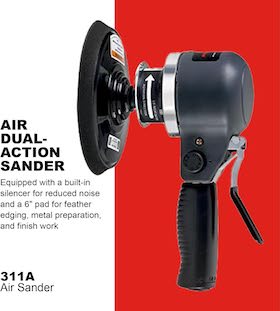

Q. Hey guys, I work for Cal State Long Beach metal dept. and we are having a problem with graffiti in the elevators (stainless sheeting). The students are engraving or scratching the semi-brushed surface and I am researching ways to cover it. I have seen "swirl" finished stainless in restaurant kitchens and such and I am looking for tips, supplies, or links/websites with more info. on how to achieve that same finish or if anybody has any other suggestions. Much thanks, Jay.

A. There is not a lot you can do. Nothing is idiot-proof when it comes to the human factor. First maybe post a sign about a surveillance camera and notice of fines. If you want to try to rework the problem afterwards, try using non-woven wheels to remove and blend in.

A. The swirl pattern that you refer to can be done with a dual action sander with an appropriate grit. It will hide the graffiti, but will do nothing to deter morons.

Q. I'm trying to add a swirl effect to 300 Series stainless with a #4 satin brush finish.
I'm using a Chicago Pneumatic CP7200S Mini Random Dual Action Air Sander Kit 15000 RPM, 10.5 CFM. Mini Random Dual action orbital sander kit with regulator. What grit/style/manufacturer paper would you recommend?

A. I'd like to offer the following in response to those asking how to make a swirl finish on stainless steel or aluminum. I used to work with used food processing equipment and we'd often do that to refurbish old equipment and hide scratches and dents, or to simply make something look nice.
1. If possible, lay the sheet to be finished on an even, flat surface. If it's already installed, such as the elevator doors mentioned, that's still okay, you just need to be able to access the entire surface.
2. Use Scotchbrite pads, or a similar nonwoven abrasive pad that will work on a high-speed right-angle or straight die grinder [adv: die grinders on eBay or Amazon [affil link] or air-tool.
3. Take a pencil or a marker and straight-edge and LIGHTLY lay out a grid on the surface to be finished. This will help you to keep the finish uniform. Start at one corner and grind/brush a complete circle. Move 1/2 the diameter over and make another. Keep repeating this process until the first row is complete.
4. Move to the next row below and, again, this should overlap the lower 1/2 of the circle above it. What you're actually doing is quartering the circles. complete the next row and continue this until your done!
It takes some practice and a steady hand; practice on a piece of scrap or something that won't be seen until you feel comfortable with it.
Do NOT use a wire brush on SS unless it's a SS bristle brush! Using a carbon-steel (mild steel) wire brush on stainless steel will permanently damage it because it impregnates the surface with carbon which will then cause it to rust later!
I don't know about the wisdom of using sandpaper to try this finish. One may run into the carbon-impregnation problem mentioned above. Another problem is that sandpaper is very flat and, unless the surface you're finishing is perfectly flat-you're going to miss areas and have gaps in your finish.
Lastly- depending on how much damage you're trying to cover, how flat the surface is, and simply how well you want it to look- doing this the *proper* way entails starting with a coarse-grade pad, then a medium, then a fine. This can be expensive and time consuming. I've accomplished a satisfactory (for my purposes) finish using one grade of pad and one pass. Again, a little experimentation here goes a long way.
