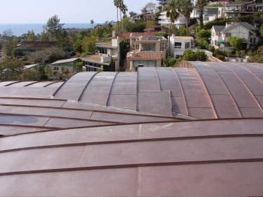

I'm a contractor in Laguna Beach, Ca. and I recently installed a copper roof. My clients DO NOT want it to turn green!
Ideally they would like it to stay brown,( like a old penny) What are my options?
NEW Construction - Long Beach, California, USA
