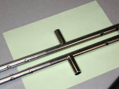

Q. T304 is not an option for us. Our customers request 316/316L. Does the added sulfur shows on the MTR? We just received a sample (see picture) where the good part had a sulfur content of 0.003% and the bad part a content of 0.013%. We also had occurrence of the problem with sulfur content of 0.007%.34414
Eric Potvin [returning]
oem for pharmaceuticals - Beauport, Quebec, Canada
A. They are normal residual sulfur levels. The range 0.002 to 0.02 percent is typical. That is, sulfur was not added during manufacture to confer free-machining properties. Free-machining sulfur levels are typically 0.2-0.3 percent.So the cause of your problem would seem to be somewhere else.Jeffrey Holmes says that T304 (I assume from the context that the "T" designation denotes the sulfurised free-machining version) is OK. The significant difference between 316 and 304 is that 316 contains 2 to 2.5 percent molybdenum but 304 contains negligible molybdenum (usually less than 0.1 percent). Perhaps the problem is related to the homogeneity of the molybdenum distribution, which would depend on the amount of deformation (reduction in cross-sectional area) of the bar during its rolling and the original size of the bar/billet/ingot that was the rolling stock. Of course you have no control over such aspects and indeed it's likely that such information could not readily be obtained. So maybe you need to stick with a supplier whose product electropolishes OK and accept that the reason for the difference isn't known.I'm a metallurgist primarily concerned with bulk properties of steels rather than surface finishing aspects - I cannot conceive that normal residual sulfur levels could segregate to give the problem you experience.
