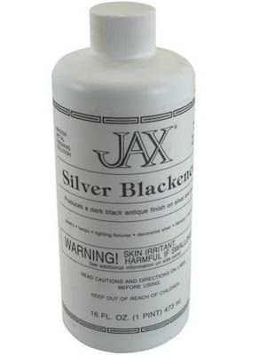

     But if true gold plating without a clearcoat, powerful oxidizing solutions like Vigor Silver/Gold Blackener are available for professional use and many sites claim that Jax Silver Blackener will also blacken gold..Unfortunately, the blackening will quickly wear away unless in recessed areas as in school rings
     It is possible, but may be impractical, to ruthenium plate or black rhodium plate gold fixtures.
Silver Blackener
(iShor.com, stuller.com, & jemcousa.com say that Jax Silver Blackener blackens gold)

Ed. note: We believe two brands are Vigor Silver/Gold Oxidizer (labeled for professional use only) and Jax Silver Blackener.
