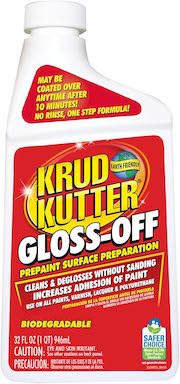

I HAVE AN OLD WHITE HEADBOARD THAT I WANT TO PAINT BLACK, IS THERE ANY PREP BESIDES CLEANING, OR CAN I JUST SPRAY PAINT IT.

Gloss Off Prepaint
Hi, Melba. The enamel on this headboard appears to be extremely smooth and glossy, which means it will be difficult for subsequent paint layers to get much "tooth" for good adhesion. I would suggest starting by lightly sanding everything. If that seems too laborious due to the intricacy of the headboard, you can try a "liquid sandpaper" or "gloss-off" product ⇨
