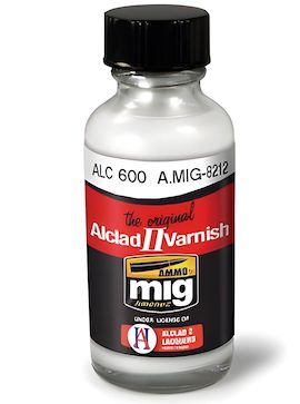

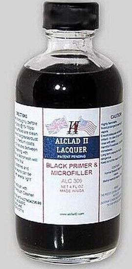

A. I have also been looking for that professional chrome finish for r.c. car shells and I have found this product; Alclad II ⇦ on eBay or Amazon [affil link] . Here's a really good guide for the correct application of it:
Alclad II black primer
alclad_primer
Holomatic Spectral Chrome
alclad_II_chrome_paint
Alclad Aqua Gloss Clearcoat
alclad_gloss_clearcoat
Alternatively, there's a more professional but expensive option called ALSA Chrome. Very expensive but quite amazing!
I hope this is helpful.
