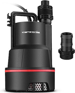

Q. I'm sorry but I have a question. I have a 8 ft round 3 ft deep pool. It does not have a filter. We have well water with salt softener. How can I get the orange rusty color out?! I have also noticed sediment on the bottom that just mixes right back into the water when I get in it. PLEASE HELP!!! Not much summer time left. Thank you !
Andrea Mensch
- Indiana USA
September 1, 2015
Small submersible pumps
submersible_pump
A. Hi Andrea. You can probably find a tiny submersible pump cheap and drop it into the sediment at the bottom of your pool. Balance an old plastic bucket on a 2 x 4 at the rim of your pool; cut a piece of old garden hose to run from the pump to the bottom of the plastic bucket. Fill the bucket with old rags to act as your filter media. Put a hole near the top of the bucket, or just tilt it, so the water runs back into the pool.
It will be a rather tepid filter, but better than no filter. Good luck.

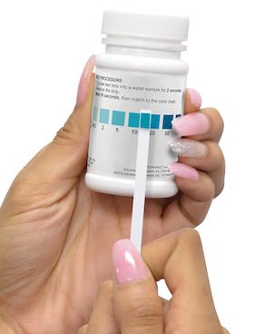

Hydrogen Peroxide Test Strips
hyd_peroxide_test
thumbs up signWe have a 15 ft. above ground pool. We filled it with well water. It turned very green overnight. Next day we shocked it with chlorine. it turn a deep orange/ brown. I searched everywhere for 35% hydrogen peroxide. Could not find it anywhere in my town. I bought 5 bottles of 3% hydrogen peroxide from the dollar store. Dumped it in my pool and it instantly turned crystal clear. 12 days later and still crystal clear. Hydrogen peroxide test strips have been ordered and are on their way. Just saying.
T Fennel
- Vancouver canada
July 15, 2016
3%
Hydrogen Peroxide
hydrogen_peroxide_3
Hi T. 35% is no longer readily available to consumers because of DOT shipping restrictions for hazardous products, but it is a very strong chemical, with hazards. I think you were much better off with the lesser hazards of the 'consumer strength' 3% stuff :-)
The reactions between peroxide and iron are very complex (strangely, since H2O2 sounds so very simple -- but look up Fenton's Reagent) and I confess that I do not actually understand them all. I'm surprised that peroxide can make iron disappear, and would not have expected it, but your experience is your experience, and many people have removed rust stains from bathtubs with it.
