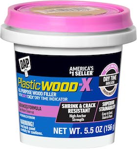

A. Years ago there was a product called "liquid plastic". it was a one-part product primarily used to finish wood. Does anyone know if it is still available and at what retail outlets?
I used it as a wood hardener/preservative by thinning it down with paint thinner and then letting it soak into the "dryrot" wood and had pretty good results. it was a lot cheaper than using Minwax's wood hardener.
John chambers
- des moines, iowa
November 21, 2014
