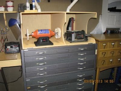

Q. Greetings, I restore antique toy sewing machines and most of the moving parts are nickel plated. I am building a plating operation of my own in my hobby room and am ready to try it out. I've just completed the power supply portion. I'm using a battery charger ⇦ on eBay or Amazon [affil link] which is controlled by a home fan rheostat. I have a volt/amp meter installed in the line.
In my reference book I'm given a formula using nickel sulphate, ammonium sulphate, magnesium sulphate, boric acid. I have all these chemicals except nickel sulphate which I'm about to purchase. Now I see in your forum that nickel chloride is used. My formula mentions nothing about this item. I'm going to be plating raw steel. I will pickle the parts after sandblasting the old nickel off. Can you help me with the bath solution? Bob
Bob Benedict- Humboldt, Tennessee USA
March 4, 2013
A. Hi Bob. Beautiful crafts room.
