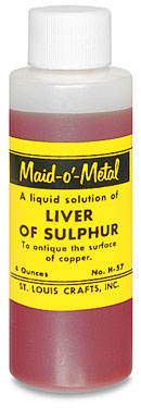

Q. I gave a bronze sculpture to one of my children which I sculpted years ago of Don Quixote. Somehow the sword he holds in his raised right hand was broken off and my son wants to replace it. He has some good ideas as to forming the sword out of a strip of copper, and re-attaching it. He wants to make the sword with the same color like the rest of the bronze. He asked me what the patina was. I told him that my best recollection it was liver of sulfur on eBay or Amazon [affil link] but I do not want him to get involved using that stuff.
Is there any household stuff he could use?

Liver of Sulfur
liver_of_sulfur
A. Hi, John. These days you can buy liver of sulfur as a reasonably dilute liquid on eBay or Amazon [affil link] , and it is possible that it may have less baggage than the stuff you remember. But it may also be possible to use crushed hard boiled eggs as a source of sulfur dioxide, although obviously the reaction with metal is far less controlled.
If you type "blacken copper" into our search engine you will see a dozen or more threads on ways to darken copper. Good luck.
