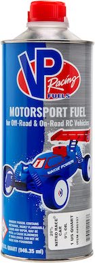

A. I was about to throw my wheels away and get new ones because I could not get the acid stains (streaks) out of them. I tried everything -- even the $20.00 a bottle stuff from the Detail Shop that was supposed to clean them.
Mothers did nothing, wheels cleaner spray from the auto parts store didn't work. So, I'm at my wits end when I decide to try something off the wall.
My kids have a remote control gas car and the fuel for it is 20% Blue Thunder Nitro Fuel .
I put some on a rag and rubbed the wheel -- AND IT WORKED! It leaves a haze on the wheel but when I went over it with Mothers Polish
Amazon [affil link] -- the darned thing looked like new.
Blue Thunder Nitro R/C Car fuel. Holy Cow.
