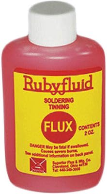

Soldering
Rubyfluid Flux
ruby_fluid_flux
A. When soldering galvanized sheet metal, always use a non-corrosive flux such as ruby fluid.
If none is available, use 'cut' muriatic (hydrochloric) acid. Do this by pouring the acid into a glass container and adding zinc (roofing nails and or slivers of galvanized metal) until it no longer bubbles.Strain the resulting liquid into another glass container. However, I might question the use of 26 ga. metal for a roofing application, for most uses it is much too thin to last for any acceptable length of time, while 24 ga. is much thicker and will be much more durable. Also, to make a strong joint the metal should be 'locked' together or at the very least riveted no further apart than 3 inches.
Gary Moran
- Agency, Missouri
! As to the use of 26 ga. or 24 ga. galvanized sheet materials in roof flashing applications, it is not the thickness of the metals that promotes or degrades the longevity of the flashing, but the weight of the galvanized coating and the applications to which the metals are applied.
The thickness, or gauge, of sheet metals in conventional roof flashing applications contributes to their span strength and performance under thermal stresses, but not to its corrosion resistance, per se. It is the amount and nature of the galvanized coating which affords the metal its primary corrosion resistance.
In short, 26 ga. G-90 galvanized sheet metals are suitable, and often preferable because of their workability, for roof flashing applications in most cases where span is limited. There is no appreciable increased corrosion resistance for G-90 galvanized coatings on thicker metals.
