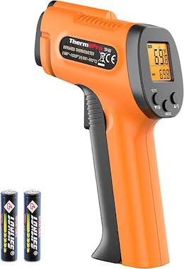

Infrared Thermometer
infrared_thermometer
if you find a response to how to measure the emissivity of a surface, let me know please.
I have another question, is there a material (natural in preference) with a very known emissivity?
said dhimdi
university of Gent Gent, Belgium
Low cost solution for the emissivity measurement is by reading the temperature of the surface by using the infrared thermometer and thermocouple. By applying emissivity correction, when the IR thermometer shows temperature equivalent to that of thermometer, the emissivity is known.

When measuring the emissivity of a surface, it is important to take into account the waveband of observation. Most commercial non-contact temperature measurement devices operate in either the 3 to 5 micrometer waveband, or the 8 to 12. Emissivity will vary with angle and temperature, as well. The method of setting the emissivity of an instrument so that its temperature agrees with that of a thermocouple works as long as the background source of infrared radiation (also called T ambient or T surroundings) is accounted for. It is possible to get false readings when using this method. For example, if you were observing a hot reflection off of steel, the total radiation from the surface would be more than you would expect to get from the same piece of steel when reflecting ambient or cooler radiation. In general, clean, specular, polished metals have very low emissivities. The emissivities tend to be slightly higher in the shorter wavebands.
