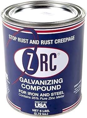

Q. Read with great interest your comments on galvanneal material. Is this material more (or less) corrosion resistant that G90 Galvanized? I am trying to ascertain the best method of welding this material in order to preserve its corrosion resistance. We utilize MIG systems and would really appreciate any recommendations as to wire types, shielding gases, etc. We are presently testing 309 stainless wire, but the control problems may be difficult for us to control in a production environment. We experience corrosion in a field environment closely linked to the areas adjacent to the welds (these areas lose galvanizing during the welding process). We powder coat our product but still have this problem in harsh/southern coastal applications. Any suggestions?

Cold Galvanizing Compund
(avail. in spray or brush-on)
cold_galv_compound
A. Hi, Rick. G90 means 0.90 ounces of zinc per square foot (divided between the two sides). More or less zinc can be applied whether the galvanizing is later annealed or not. Typically, cold galvanizing compound ⇦ on eBay or Amazon [affil link] is applied where the galvanizing has burned off.
