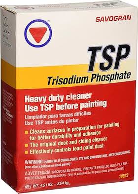

Q. I have wondered what kind of paint do I need to paint my galvanized steel roof. Where can I buy the paint.
RANDY BUI
- BERLIN, MARYLAND
TSP / Trisodium Phosphate
trisodiumphosphate
A. Hi, Kevin. Extend, Ospho, naval jelly, rust converter on eBay or Amazon [affil link] s, etc., are phosphoric acid based compounds, and the idea is that they convert red rust to a combination of a more adherent and less porous black rust, plus phosphate conversion compounds. The very best paint jobs, like OEM automobile painting, always include a factory applied phosphatization before painting. These after-market products, applied under field conditions, are not as good as true phosphatization, but they simulate it to the extent possible.
Hi, Randy. Unfortunately your question is just a bit vague, because we don't know the age of the roof or why you are painting it. If it's quite old and rusty, any primer for metal, followed by any outdoor paint designed for metal is probably okay, although a rust converter on eBay or Amazon [affil link] first might be a good idea.
If it's a newer roof, the galvanizing can definitely cause you adhesion problems. Scrub with trisodium phosphate on eBay or Amazon [affil link] , then use a self-etching primer for galvanized surfaces. Good luck.
