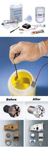

Q. I'm a car guy that has developed some fixes for my British car that I share with the small community of like owners. I make these parts because I have the time and ability, and sell them to owners that have neither time or ability. I've developed rubber parts and rebuilding of mechanical parts as well.
In this case, I'm developing a remote trunk unlock system that uses a cable (like a bicycle brake). The latch was originally cad plated and items I get for rebuild are generally slightly rusted or missing the cad plating.
I purchased a nitric acid-4%/cadmium-0.1% mixture from Grainger's and need to know how to plate these small items - about 3" x 2" in size. I have low voltage power supplies available.
What's the voltage? Anode/cathode material (which is which?) Time in tank? Dilution of the purchased mixture necessary? What do I add to get the gold/yellow/green color?
Any help would be appreciated by the Jensen Healey community around the world ! THANKS.
- Moorestown, New Jersey
January 20, 2011
A. Hi, Pete.
There was a time when lead was used in gasoline, mercury thermometers and mercury treated hats were a commonplace, cadmium was plated onto miscellaneous auto items, and hexavalent chromate conversion coatings of gold/yellow/green were fairly widely used. But those uses are all history because of toxicity.Cadmium is plated only by a few plating shops today, and basically only on some exotic legacy aerospace applications; and even this will be short lived. Regular blood tests and other medical monitoring are required. Similarly, hexavalent chromate conversion coatings are a rarity (especially after Erin Brockovich [link is to movie info at Amazon]) and European RoHS requirements, with almost all shops having converted to proprietary trivalent chromium conversion coatings.
The cathode is the component that you plate onto, the anode is the chunk or slab of metal you are dissolving in order to plate out. Electroplating is a reduction process, and you will not be able to electroplate from an oxidizing acid like nitric acid. Although it is easy to do electroplating as a simple science lesson (see our FAQ: "How Electroplating Works"), robust electroplating on rusted components is not a simple process. However, Eastwood offers a tin-zinc plating kit =>
They also offers a paint designed to imitate the color of cadmium, Eastwood "golden cad" [linked by editor to product info at Amazon]. This may give you an acceptable iridescent yellow color. Good luck.Regards,

Thanks for the quick response, but I was hoping for it to be a bit more positive.... I'm and old school guy, but as an EE, I had a staff of ME's and Chem E's to work out the plating issues (we never did Cd or Chromate Conversion coatings). Back in the days, we used dilution to prepare the laboratory's effluent in preparation for discharge from the facility. I'm aware of industrial risks, as I've worked with 50kV, megawatts of RF energy and even machining/sanding Beryllium metal in the past. I survived all that, with (and without) the help of OSHA so I figure I can handle the Cad -- yes, I did read the MSDS!
I'm aware of the Eastwood offerings, but the guys that buy and trade my kits know me to be a real nit-picker and I'd like to say that the bits were prepared to the original factory conditions, and not just painted to look like it. Cad plating plus the Eastwood overspray would be OK.
I was hoping that the Cd in the bottle of Grainger solution could be used to plate-out onto my parts, which have been sandblasted to bare metal (steel). Also have "stuff" to clean the parts with prior to plating.
Bottom line is the material I have just will not do the job--correct?

A. Hi, again.
The test solution which you mentioned, besides being based on nitric acid, is too weak for utility by a factor of a hundred or more. Commercial plating solutions based on cadmium cyanide are available from any plating supplies distributor, but even with your wall full of experience, they may be unwilling to ship to you for fear of liability--you can ask. Established plating shops are subject to so many EPA and OSHA regulations that a vendor can be confident that the buyer has had yearly Hazmat training, wears proper PPE, has an emergency preparedness plan, etc. I know that you only want to buy a very small quantity; I'm just explaining why it may be hard to find a vendor, despite them being in every large city.In truth, if I were a chemical salesperson, I would not sell cadmium to a hobbyist, not only because of potential accident liability but because cadmium is a biocumulative poison that the Air Force is spending millions of dollars annually trying to remove from the remaining life-critical applications, and authenticity of restoration isn't a life critical application. But not everyone is as concerned; I believe you can still find this poison on some brake linings :-)
A large library will have electroplating texts with a chapter on cadmium plating, explaining the interrelationships of the variables; access to Mil specs for cadmium plating is free (https://assist.daps.dla.mil/quicksearch/). If you are far more patient than me, you can probably find operational parameters on the net on this site or others, a nickel and dime at a time. Thanks for the kind assessment, and good luck.
